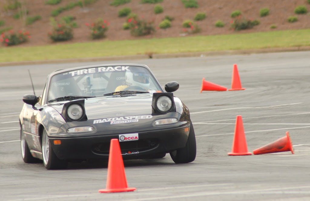

    Re: Wheel options for Miata
    Well, as a reference, here's what you're looking @ in terms of bump travel on the 15x7.5 6ULs. This was @ the Atlanta NT running 195 'Stones
    Will the 225 toyos fit? Who knows... they're not out yet lol. And by the time they come out, will they be the best tire for the class? Again: Who knows ;)
    I'll have the rear suspension apart here in a month or so regardless, so it won't be a much of a stretch for me to pull the springs off and run the suspension through its range of travel and take some pictures and measurements of what kind of room we're looking at.
