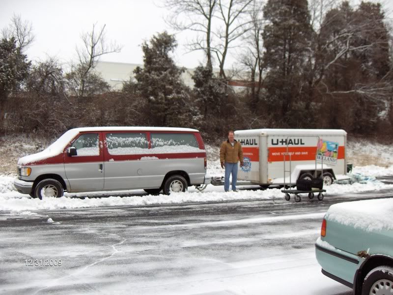

    Don't be scared of a V-10 Ford either. I have this engine in my van and it pulls our 24" store trailer fine just about anywhere you want to go. Towing, it generally gets about 2-3MPG less than the diesel truck towing the same trailer/similiar weight. The only time it is really brutal on mileage is if you have an entire trip with a huge headwind. We went to the Dallas Tour 2 years ago and had a 35mph headwind the entire 600 miles. The van mileage dropped to about 5.5mpg!. But, the diesel on the same trip dropped to 8ish.

    Excellent data point on the V10 Dave. That has been my experience. I have towed with a Ford E350 (van) 6.8 V10 and loved it. Mileage wasn't noticeably different that my V8 gas van and power was nearly diesel class. Speaking of vans....
    Clemens, have you considered a van? A Ford 1 ton Clubwagon can be bought for about half the cost of a similar pickup. You will find a number of van users around here. I have used a van for many years and would only consider going back to a truck was if I needed to tow a 5th wheel or goose neck trailer. Vans have more cockpit room, more passenger room and luggage space and still have the space of a pickup bed in the back. Plus, your stuff is locked up inside.
    While van's don't have the "image" of the diesel trucks, they typically work better as daily drivers than trucks. I have had three and loved them. My current van I had originally bought as a temporary tow vehicle while I shopped for a diesel truck. I liked the van so much I quit truck shopping. For a while I shopped for a diesel van but haven't run across anything that I just had to have. As I noted earlier, my current van just passed 290,000 miles. I hit that mark while towing between Florida and the DC area between Christmas and new years. I made 3 runs (900 miles each way) hauling my shop equipment and cars up, totaling nearly 6000 miles in just over a week. I towed in all kinds of weather including two huge snow storms one of which I towed over the Blue Ridge mountains (I-77 at the NC/VA state line) towing a UHaul loaded with 4000 lbs of shop equipment and another 1000+ lbs of tools in the van. The CAT scales at a truck stop in Georgia had the whole rig at 11,000 lbs.
