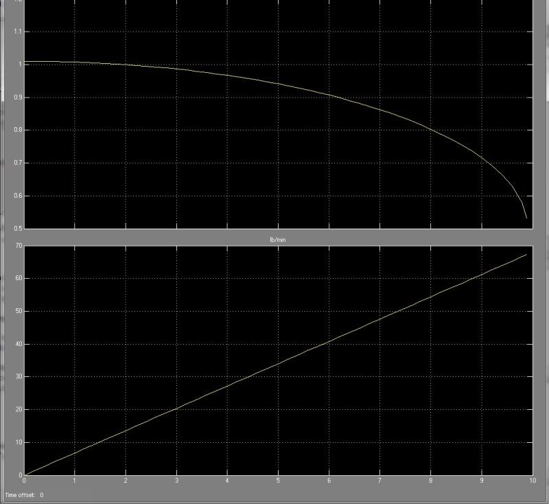

i have a simulation i built for sizing injectors/restrictor calculations and turbo efficiency selection a while back. i extracted just the restrictor flow rate calculations for this example to see what kind of power the different restrictors will make. for the current 52mm restrictor it can flow near 67lbm/min good for between 637bhp and 670bhp. if you assume a 18% driveline loss thats 522whp. your car mark isn't even maxing that out with the FP HTA green which is rated at roughly 54lb/min. the turbo is your limiting factor, not the restrictor.
so what would happen if they cut it down to the 38mm restrictor? i calculate about 36lb/min good for 342-378bhp and 18% driveline loss for about 280-310whp. thats a big loss in power!
to verify my sim i used the NASA mass flow choking calcuations here: http://www.grc.nasa.gov/WWW/K-12/ai...flchk.html i was within 1% accuracy. i wanted to check again for a known restricted car i have tuned to the maximum which is the FSAE car with the 18mm restrictor, flowing roughly 8lb/min, good for 84bhp, or ~75whp with the much lower driveline loss of 10-12% (dog box tranny, RWD, chain driven). which is what most people get out of those cars.
One extremely important thing to consider with the restrictor use though, as mass flow through the throat increases, downstream pressure decreases. this downstream pressure is actually the inlet pressure to the turbo. the inlet pressure is part of the pressure ratio (Pout/Pin) you use to map the compression efficiency of the turbo. normally, with a large intake, the Pin value stays at atmospheric pressure because a large intake isnt a restrictor and minimally loses pressure. with the restrictor the pressure drop is a function of the size of the restrictor and of course the inlet temp and pressure differential (and for pre-turbo restrictor, the P1 pressure is atmospheric, and temp is usually also atmospheric +- your engine bay temps or air filter location).
here is the outlet pressure plot with the 52 mm restrictor from my simulation:
the top plot shows the outlet pressure of the restrictor (in bar absolute). you can see it drop off significantly as the mass flow increases. the bottom plot is the mass flow in lb/min. what your looking for is what the outlet pressure is, compared to the amount of boost you are running. for example, if you are running 30psi at the outlet of the turbo, and your inlet pressure of the turbo is .95 bar (roughly 30lb/min mass flow rate), your pressure ratio for the turbo is 44.7psia/14.7 = 3.02barout / .95barin = 3.2 Pr. this can be used for calculating the efficiency of the turbo by plotting it on the compressor map. almost always if you run to much Pr the efficiency drops way off though. so look what happens on that plot if you run it near the choke point of 67lb/min. the downstream pressure of the restrictor is now .54bar, look what that does to your pressure ratio of the turbo: 3.02barout/.54barin = 5.5Pr !!!! i can't even find a compressor map that has an efficiency point that high. so its obvious if you start running down the curve, that your turbo will loose efficiency even though the restrictor can flow more. intercooling and E85 can improve some of the losses due to inefficient heating and restore some of the air density going into the engine, but it still is a loosing battle.
SOOO, in conclusion, for the current rule set, Jeremys car is nowhere near the limit of power for FP. he clocked in at 396whp, far below the 522whp the 52mm restrictor can flow. assuming hes flowing roughly 44-46lb/min (the max the stock 9 turbo is rated at) you can see hes still at a healthy .9bar turbo inlet pressure with the 52 mm restrictor.
Mark, your car proves that you can make signficantly more then what jeremy makes. if your making 475whp, it puts you in the 52-55lb/min (what the HTA green is rated for) it shows your at a turbo inlet pressure of about .82-.85bar, so still not terrible, but not perfect either.
if you guys all get dropped to the 38mm restrictor you'll all be hurting for power.
