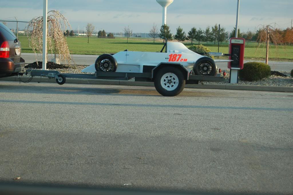

    How hard would it be to build a clamshell like that for a standard open trailer? Seems something like that (even if it was just pull on/off with something like hood pins for fastening) would be a cheap & easy way to "enclose" an open trailer for a minimal weight penalty.
    pru
    Posts:151
    30 Nov 2011 10:24 AM
    Check out the ApexSpeed thread May '10: Open or Enclosed Trailer. Post #14 contains a link to a photo of Barry Ott's old FF trailer which I find to be one of the best designs I have seen in this regard...
