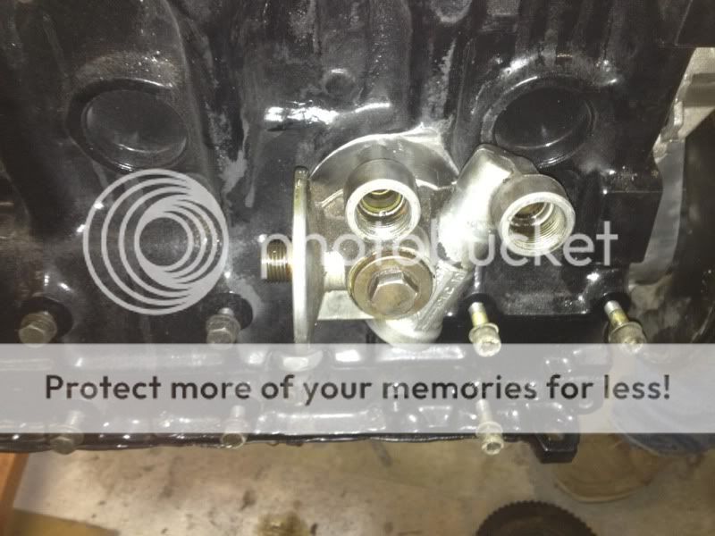

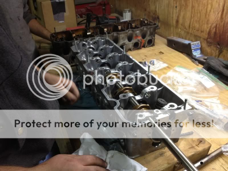

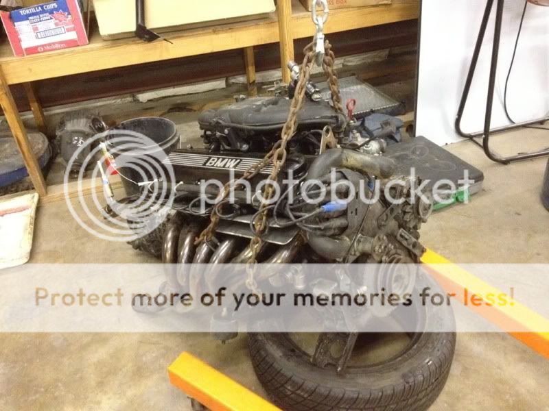

    After a tortuous autox season and 350,000 miles of hard driving my beloved bmw e30 finally breaks a rocker arm (7k RPM+ I6=broken rocker arm). Not to mention a tremendous amount of oil blow by from the piston rings, and an enormous amount of valve clatter. It's time for a REBUILD!!!

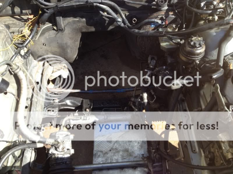

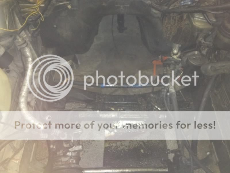

    out with the old...
    look at that mess (i think every seal was leaking)
    that's better

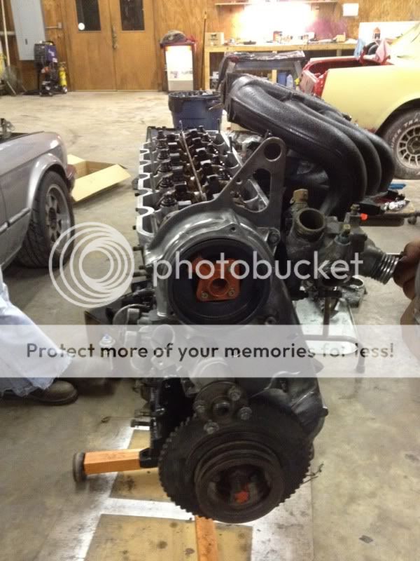

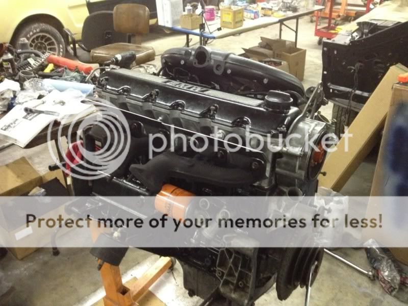

    fresh rebuild cylinder head

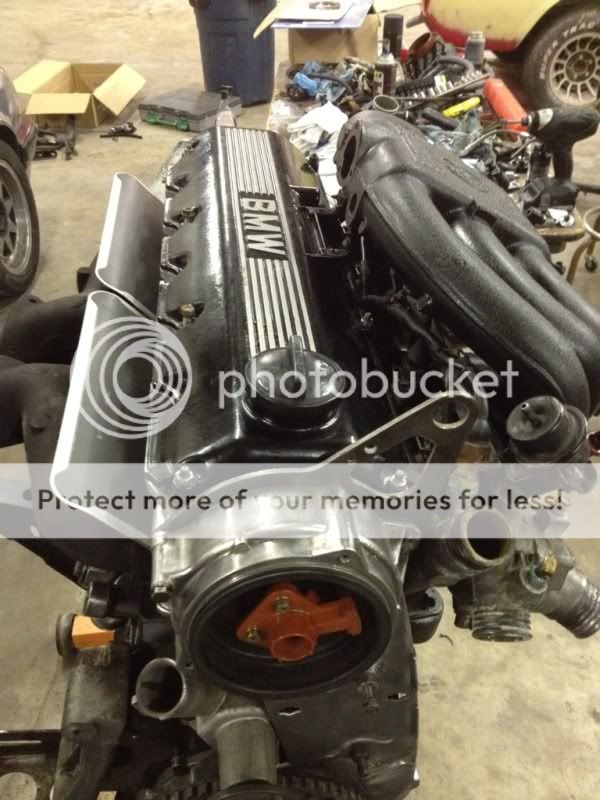

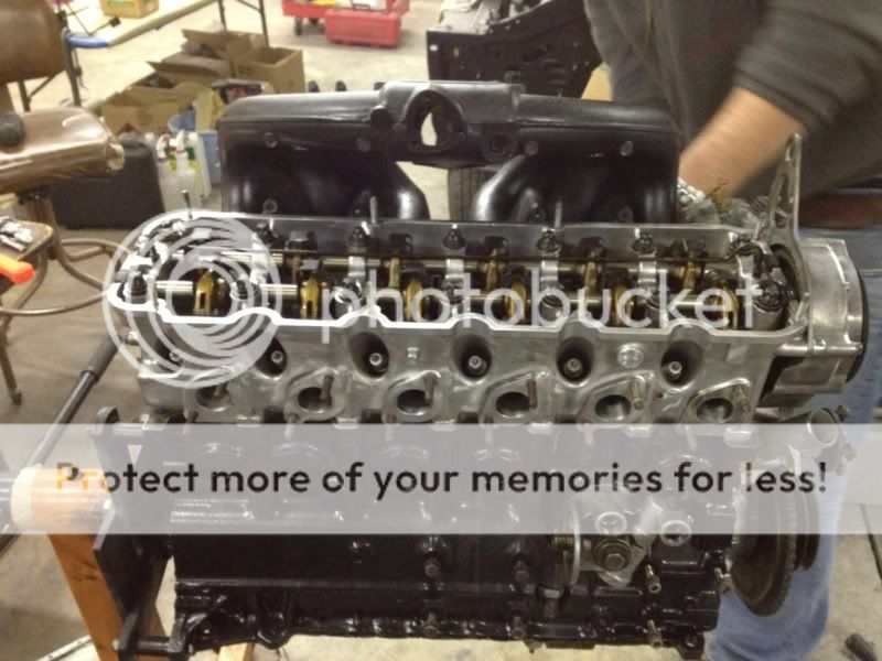

    head is now bolted to my pre-owned block (thanks pull-a-part)

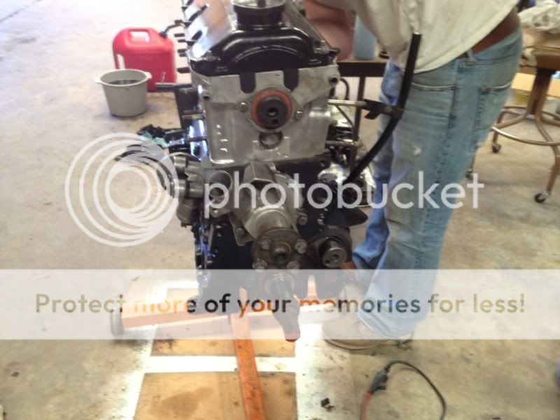

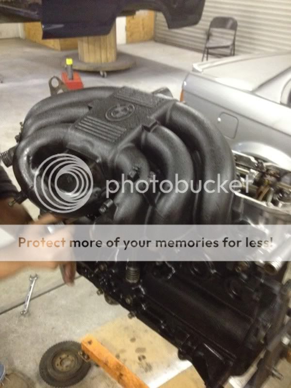

    pretty much assembled....time to put her in the car

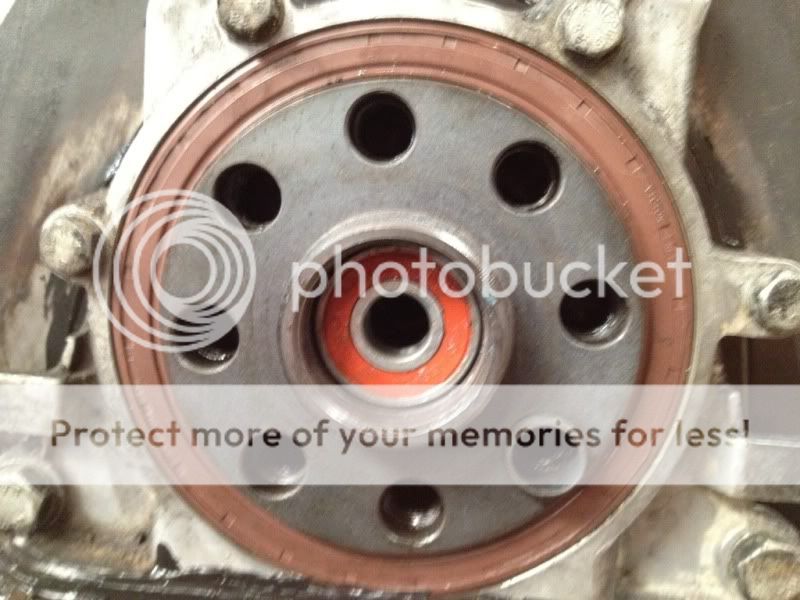

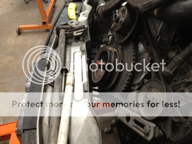

    I ran into a snag...seeing that the automatic car I pulled the donor block from did not have a pilot bearing, I had to source one Sunday morning

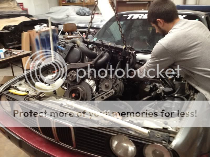

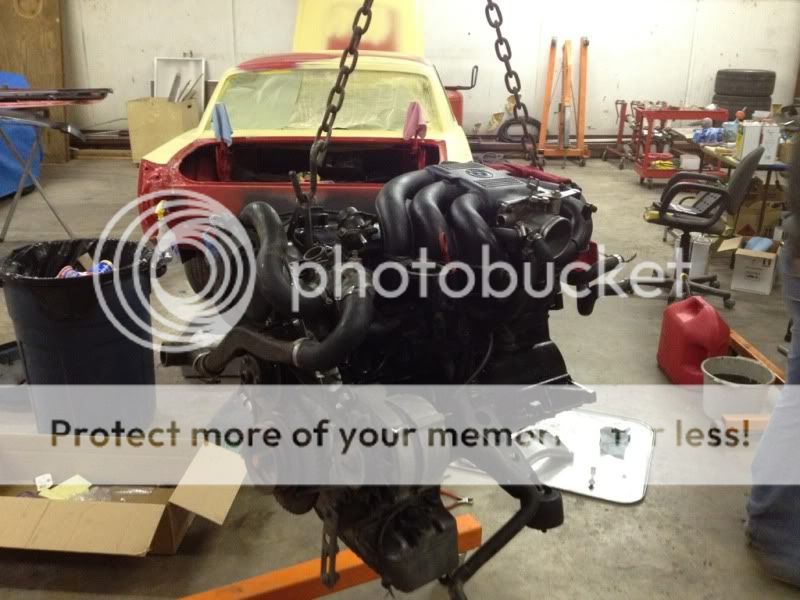

    back in she goes
    kinda tight!
    The motor is back in and running awesome!!!! No leaking or burning oil, and a lot more torque than before.
