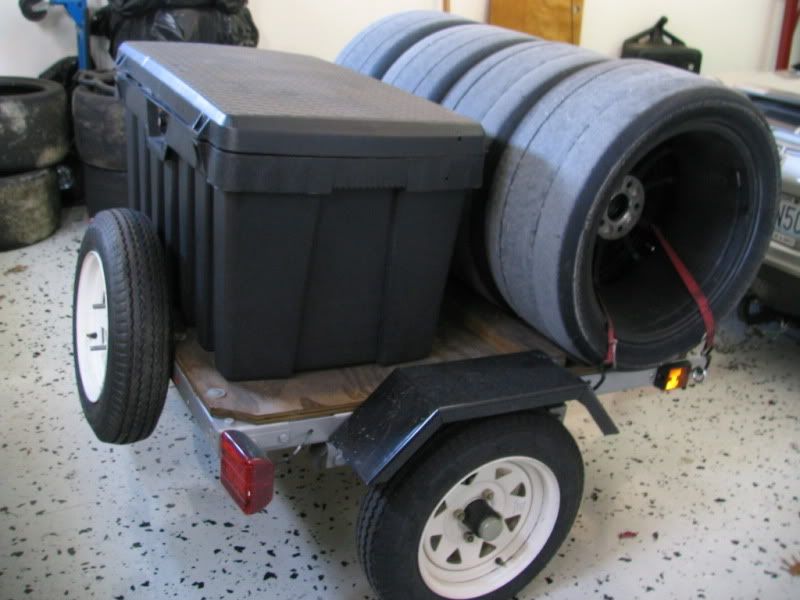

    Although I avoid the Chinese junk palace called Harbor Freight like the plague, I did purchase their little utility trailer (the upgrade version with the 12" wheels) for my race rubber (WAS 295x18 A6s, and now 315 A6s) and have been VERY satisfied. Very early on I bought some REAL tail light assemblies from a trailer supply house to replace the trash that came with it. Also, the grease fittings on the wheel hubs were just as bad. With that done, this has been a great little piece of kit. I did put a marine plywood deck on it. I stand of the tires side by side on the front half with motorcycle ratchet straps that I hook to the sides, and the back half has a big blow molded box for all the needed tools. Handy given that I Solo a Sky !!!!

    Respectfully, the 12" wheels/tires are vastly better for highway towing. Those poor little 8" tires must be breaking the sound barrier at 75mph.

    Here are the pics. I have used the supplied u-bracket to mount a spare tire/wheel to the back and added the front jack wheel. Also added are the eye bolts for the straps. Got anal this summer and spray bombed the trailer to match the car (like THAT matters). When I replace the 18x9's with 18x11's the stack of tires will become about 5 inches wider so I may have to install some sort of outriggers for the outside tires. If the wheels have center holes, I may pile them up in pairs. YTBD.
