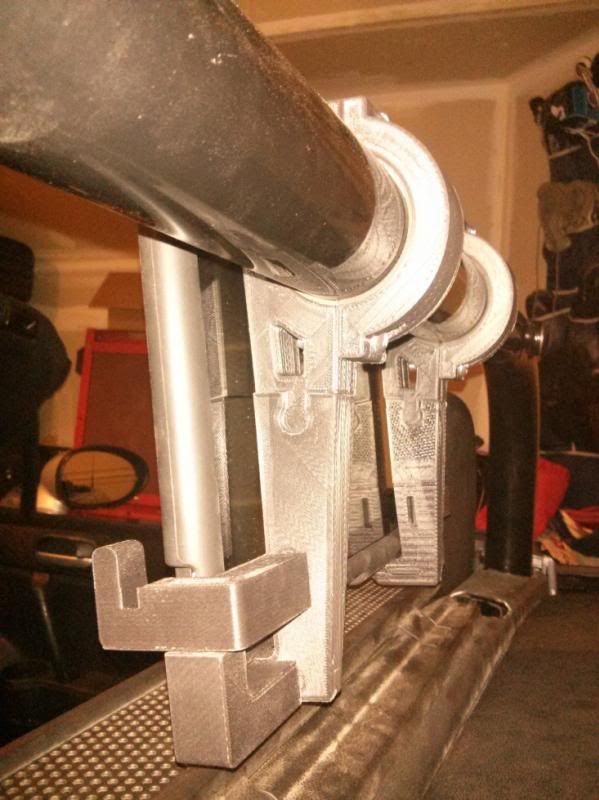

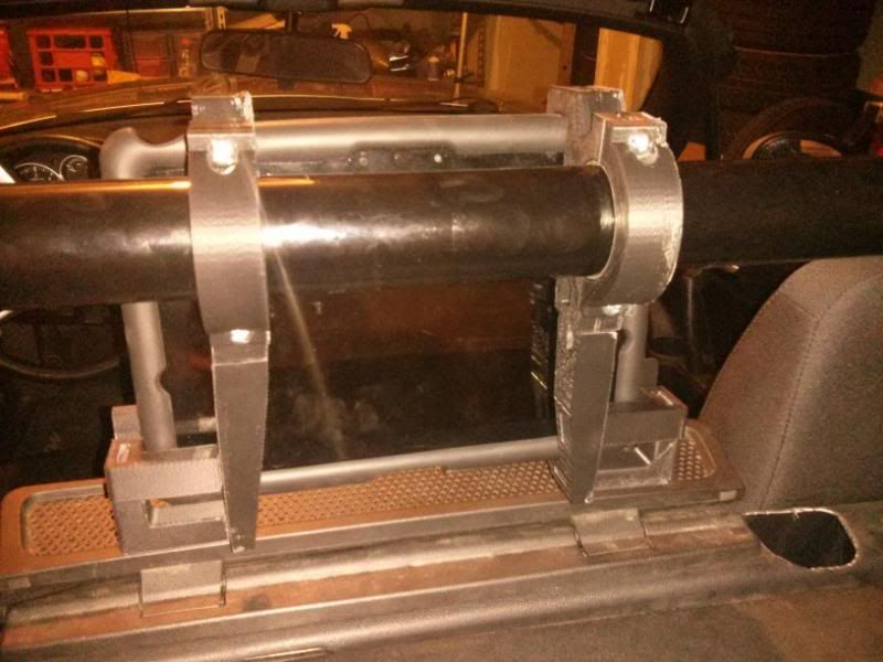

    As some of you might have noticed at Turfway, I got a Solidoodle 3 and my first project was to get my tablet mounted to the roll bar so it could be forward looking and get good video with Solo Storm.  I probably overdid it a bit, but it is important to have a solid design for this as it is using the internal accelerometer too.
    [URL=http://s2.photobucket.com/user/viars3/media/Solidoodle/IMG_20130703_194735s.jpg.html][/URL]
    [URL=http://s2.photobucket.com/user/viars3/media/Solidoodle/IMG_20130703_194749s.jpg.html][/URL]
    Unfortunately this was quite a bit of plastic and 24 hours of print time.  A little bit too much time and material in it.

    It looks really nice. A friend of mine was telling me about how 3d printers work and I'm really excited to see one being used in his way. How long did it take to design that?

    Well I am very familiar with drafting back from school days so really the design took about 3-4 hours.  Probably spent at least 6 hours with the printer as this was early on and I didn't want to abandon it too much.
