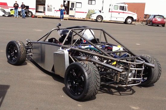

    01 Mar 2014 12:35 PM
    First pictures of build

    dgoetz
    Posts:70
    07 Mar 2014 03:04 PM
    I will compete in it in a 3 state area, Utah,  Idaho and Montana. If i get it worked out quick enough I plan on competing at Packwood, WA both weekends.
    dgoetz
    Posts:70
    03 Jun 2014 11:44 AM
    Getting close to completion
