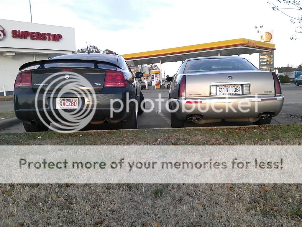

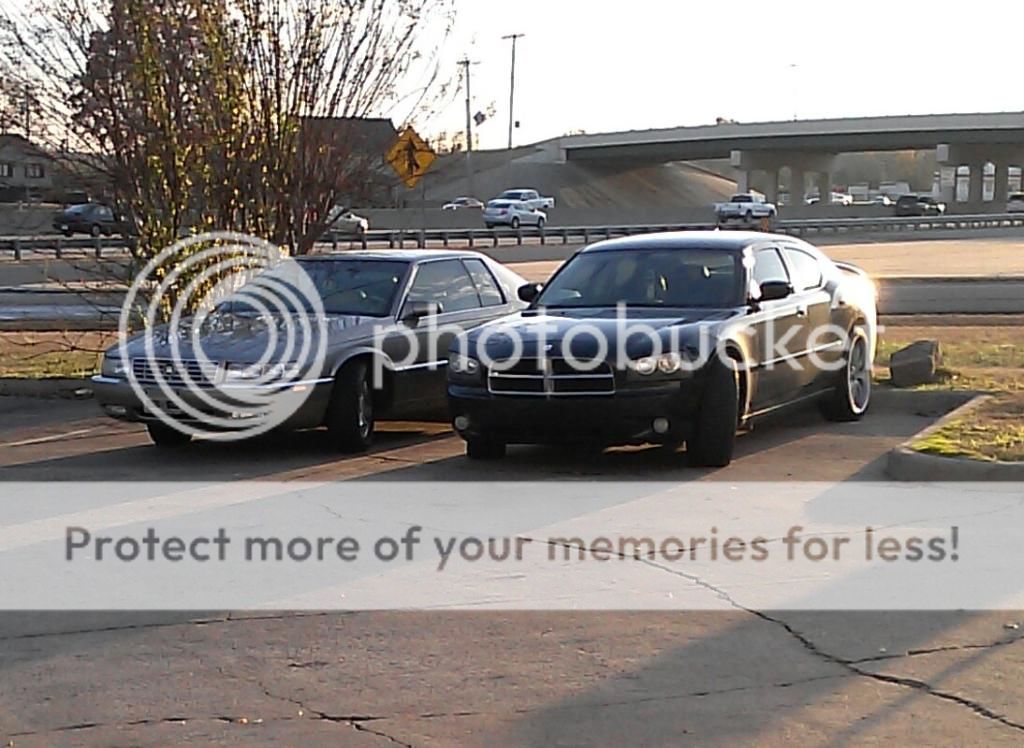

    As the pictures show, this is not a big car.
    [URL=http://s798.photobucket.com/user/kaywoodcove/media/2002%20Eldorado%20ESC/02%20Eldorado%20ESC%20Build%20Thread/0707140856-1.jpg.html][/URL]
    It’s rear end is only 28 lbs. heavier than an SN95 Mustang Cobra's and its front end is only 110 pounds heavier than the V6 Grand Prix front.
    [URL=http://s798.photobucket.com/user/kaywoodcove/media/2002%20Eldorado%20ESC/02%20Eldorado%20ESC%20Build%20Thread/1217131620.jpg.html][/URL]
    Its weight distribution is 63/37 which I have been told is close to the CRX, so not too nose heavy to get it to corner.
    [URL=http://s798.photobucket.com/user/kaywoodcove/media/2002%20Eldorado%20ESC/02%20Eldorado%20ESC%20Build%20Thread/1126131623-1.jpg.html][/URL]
    It shocks some people to learn how much bigger the Chargers are than this Cadillac.
